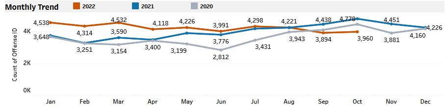

I am trying to create a line graph in ArcGIS Dashboards that shows a monthly crime trend. I am trying to make each line a different year with month on the x-axis and incident count on the y-axis, similar to this chart:

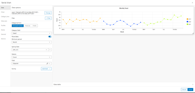

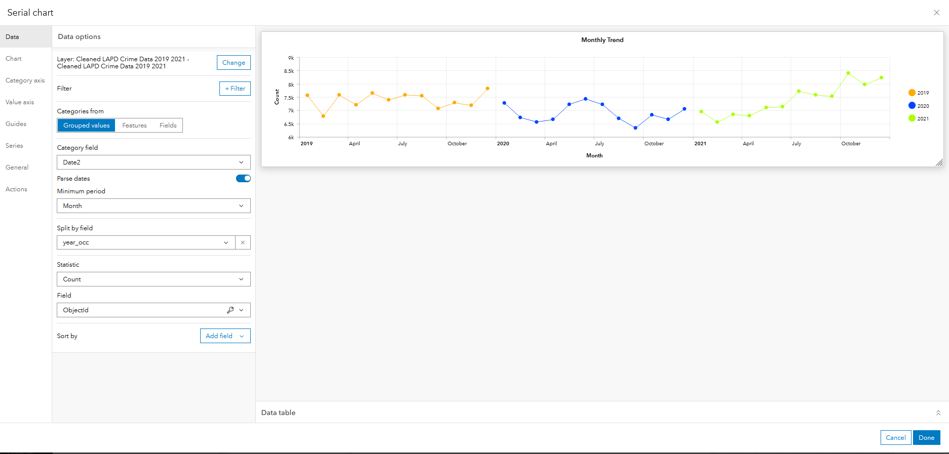

However, in Dashboards the closest I can get is this:

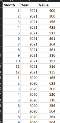

You cannot use a date field to get the look you want. If you reformat your data to include the following fields: Month, Year, and Value.
Then use the month field as your category field and split it by year.

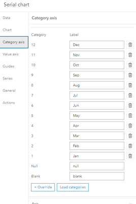

To ensure the order of the months is correct, I would recommend using the numeric value and then using the categories label to set the month text.
