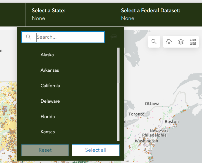

This is what I want it to look like:

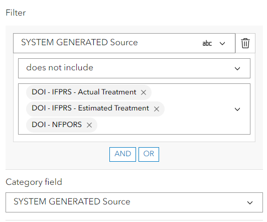

The category selector is configured to display categories from grouped values, based on this filter to remove the federal datasets:

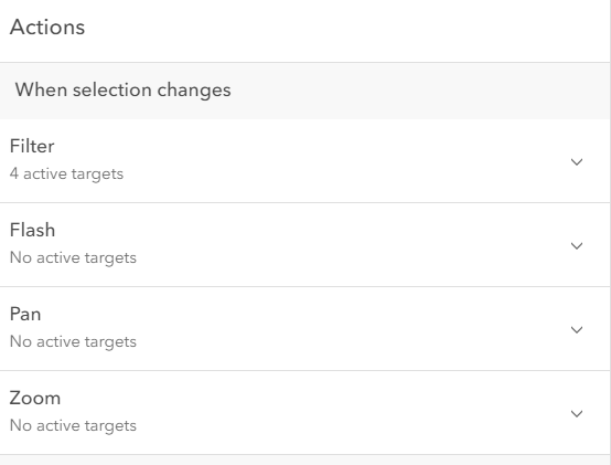

The category selector works IF I only have the Filter action. If I try to add Flash, Pan, or Zoom in addition, it gets stuck on the "loading" state.

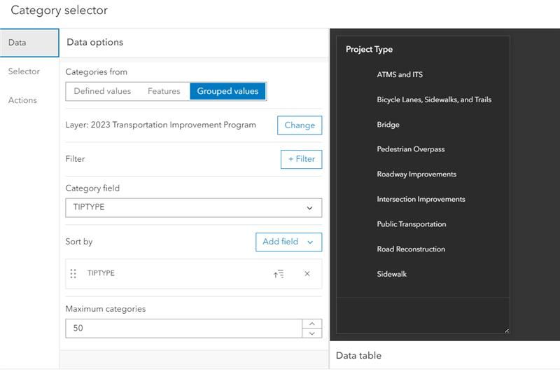

Having a similar issue, dashboard allowed zoom option on the category selector but now it is no longer there. Was having the same loading problem only to realize it was due to the fact that when updating my data, I previously was zooming to features that used grouped values which apparently is no longer supported? For whatever reason after updating the dashboard this zoom option is no longer there. 52390afd-94b5-4009-b025-cedf55b27c69.jpgGrouped values875f0123-3f8a-4bcf-a9e4-f545206d5c8c.jpgShowed zoom optionEsriCapture.PNGZoom option is now gone??
