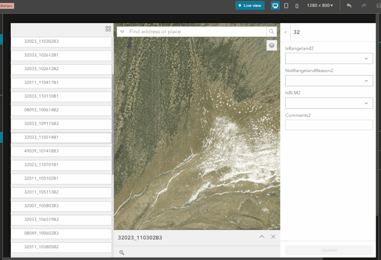

DougBrowning
MVP Esteemed Contributor
@DerekLaw I was also surprised to find that I could not do this today.
The vision here is
A list widget on the left listing each item the user has to work though.
A map in the middle with several layers the user needs to make a determination on a point.
A new style web editing form from the new map viewer at the right for the user to edit a few fields based on their determination.
This way a user can work down the list they need to do while quicky editing on the right.  We had all of this setup in Geocortex and it was slick.  We are really struggling to recreate this in Arc.
ExB does have an edit widget now but ExB still has so far to go.  Plus I think I lose the ability to do data expressions.
Please consider opening up Dashboards to editing.  I get what you are saying but your customers are asking for it.  thanks for considering
DougBrowning
Edit here as I was able to get some of this in Experience builder actually.  Data expressions still an issue I think.
