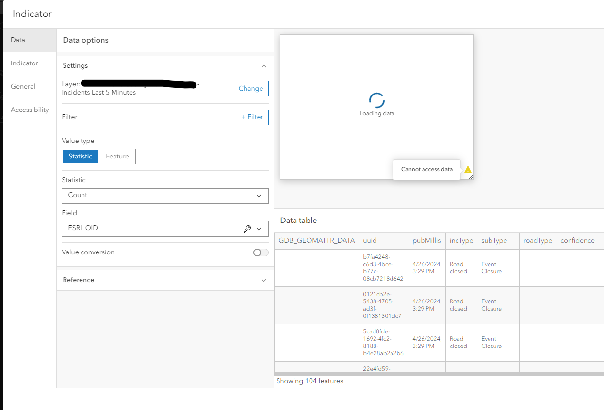

Hello!
I have a standalone ArcGIS Server service, added to an ArcGIS Online Web Map.
In my Dashboard, I can view this layer in the map widget or use it as the source of a table or chart.
However, when I try to use it as source of an Indicator, I get a "Cannot access data" error.
You can see in the sample data table that the data is accessible but that "Loading data" indicator just continues to spin.
I'm not having the same issue with other layers on that server.
Any ideas?
Thanks!
Jill

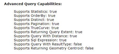

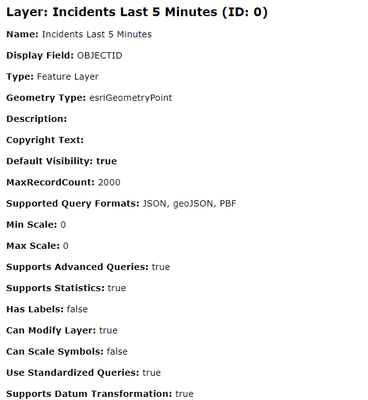

Can you go to the service and look at its capabilities? Maybe it doesn't support those sorts of queries for grouping.
Can you make a chart, for example?
- Josh Carlson
Kendall County GIS
JillianStanford
Hi @jcarlson ,
Thanks for the reply.
I thought about the service capabilities but nothing stood out to me (screen shots below).
I am the publisher of the service so I can tweak it as needed.
I can make a simple chart based on feature values but I can't make one based on group values. So, I do think it has something to do with aggregating the values.
Jill
