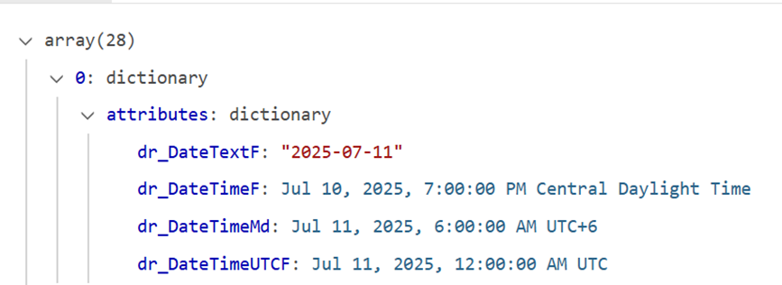

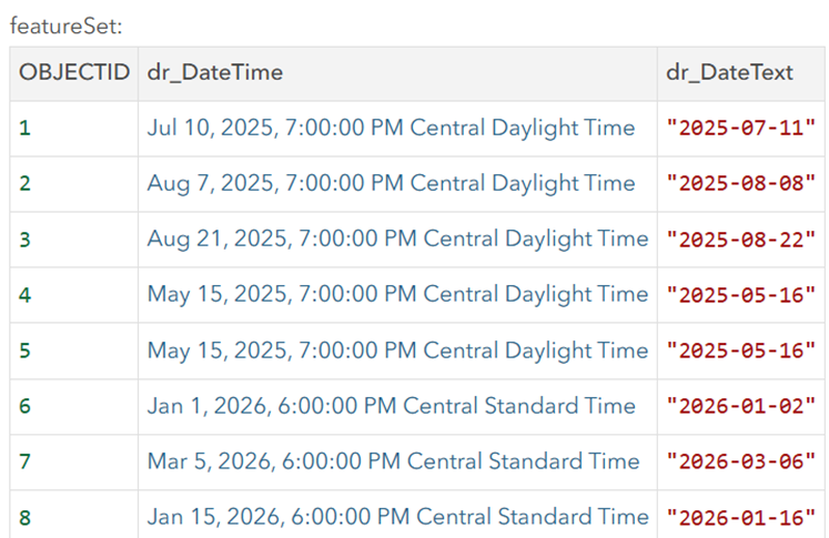

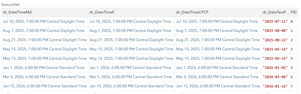

I am creating a data expression in dashboard, trying to convert data fields (from Central Time to UTC). When I look at the individual features, it's working, everything looks like I want it. However, when I push to the featureset to be used in a table , ALL the date fields have the same values...
What am I doing wrong?

raw featureset
Each individual features:
Final featureset
