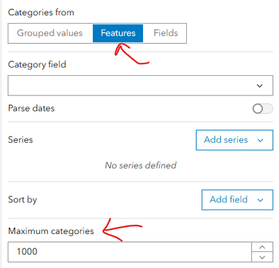

AndreasHall
If it is a serial chart with categories from Features you can limit the Maximum categories to 1.

Ah, I see. Thank you Andreas. This is how I have the chart set up now. (see attached)
AndreasHall
Perhaps you could limit it to show data from only one of the selected point if you would use a Data Expression as your input layer in the serial chart. Someone more fluent in Arcade might be able to help you with that.
