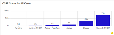

JoeStefanoni
I'm having the same issue with a data layer.  It displays fine in an Indicator and a Series Chart but when I select a subset through a category selector, the Indicator updates to the new grouping (in this case a county in New Jersey) but the Series Chart does not update and I get the cannot access data error.  I would think both items relying on this dataset wouldn't work but it's just the series chart.
