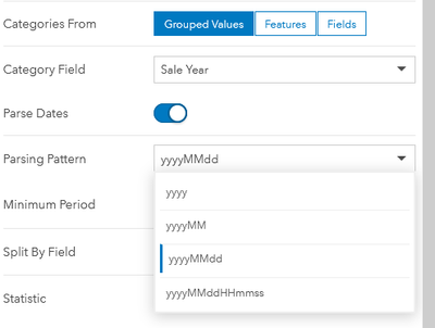

So, your options are sort of limited. A chart set to Grouped Values or Features can Parse Dates.
But this requires your date field to be in the specific patterns available. You could alter the CSV to display yyyyMM values and this would work. Then set the chat's Minimum Period to Month.

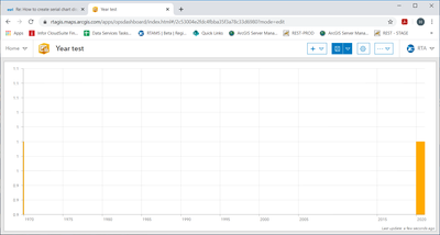

I reformatted my fields to YYYYMM in the csv (attached) and set the chat's Minimum Period to Month.  But still not having any luck - getting a weird result.    Thanks again for your help on this....

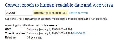

Given that some of your values seem to be getting tossed over to 1970, I'd guess that your year/month field is being interpreted as an integer? Underneath the formatting, a timestamp is really just an integer, and a timestamp of, say 202001, comes to to January 3, 1970.
I'd guess that your CSV values are being interpreted as integers, which themselves can be directly converted to timestamps, so it's probably parsing them that way. Can you "force" the field to be interpreted as a string? Or create a new string field and copy the values as text?
It seems even stranger that at least one of your values is correctly 'landing' in 2020, but the others don't.

Also! I was working with the Beta Dashboards, but in the standard Dashboard interface, the parsing options are a little better.
Try using YYYY/MM so that the "/" character keeps your CSV data as text, rather than casting it to integers.
