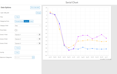

Well, I took the CSV you shared and uploaded it, then published as a hosted feature layer. Letting it keep the date field as a "date" type appears to infer the dates as being in MMM-DD format, defaulting them all to this year.
On a second attempt, I told the import tool that it was a "string" field, but I didn't alter the formatting. Here's my serial chart:
Without applying a sort, it takes the features in objectID order, so as long as the CSV has them in order, it comes out okay.

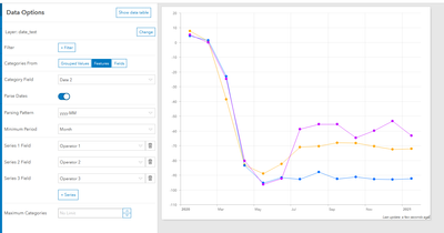

Here's a field I added, Date 2, in which the dates have been re-written as YYYY-MM:
And here's the serial chart based on that field, using Parse Dates:
EDIT: Meant to add, your CSV has several empty rows at the end, so that could also be why you're seeing values way over in 1970. I'd left the empty rows in on the first upload, and I was getting a wonky chart just like you posted earlier. Removing them prior to upload helped.

RTAAdmin
THANK YOU!
I really owe you one.  If we ever meet in person, I owe you a drink.   Thanks so much for this - you solved a problem that ESRI tech support hasn't been able to resolve for weeks.
