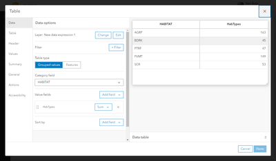

I use the GroupBy expression like this to get the counts of each attribute in a field (Habitat).
var totalHabitat = GroupBy(fs, 'HABITAT', { name: 'HabTypes', expression: '1', statistic: 'COUNT' });
This gives me this table by setting the Category field to "Habitat" and getting the sum of the "HabTypes" field.
