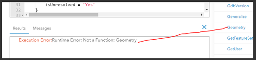

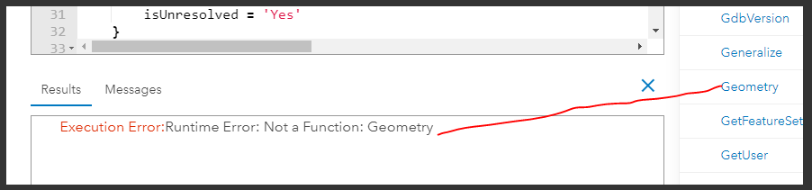

When building a FeatureSet in the data expression I am trying to use geometry but it says that Geometry is not a valid function for some reason? Like umm its right there dude.
Here is the code.  I found a post showing this but so weird on the function.

It's in line 15. The parameter is includeGeometry, and you don't actually need to explicitly reference it, you can just put "false".
The problem you're seeing is that in line 15, you're actually setting geometry to false. So later in your expression when you try using Geometry(f), that's equivalent to typing "false(f)", which won't do anything. So you get that "not a function" error because you've overwritten the function with a boolean.
Adjust line 15 and see how it runs.

Sorry it actually cut my code off.  The top two lines were calling a diff layer that does have geometry turned on.
var p = 'https://arcgis.com/';
var tbl = FeatureSetByPortalItem(Portal(p),'713e3aaef9674e3493a64347d333b618',0,['Project','PointID','StreamName','PointType','OrderCode','EvalStatus','Trip'],true);
But you are correct that it is includeGeometry.  I got that part from some other code that was posted and I never double checked that.  How weird it never once complained on it.
The complete code now does work.  thanks!
