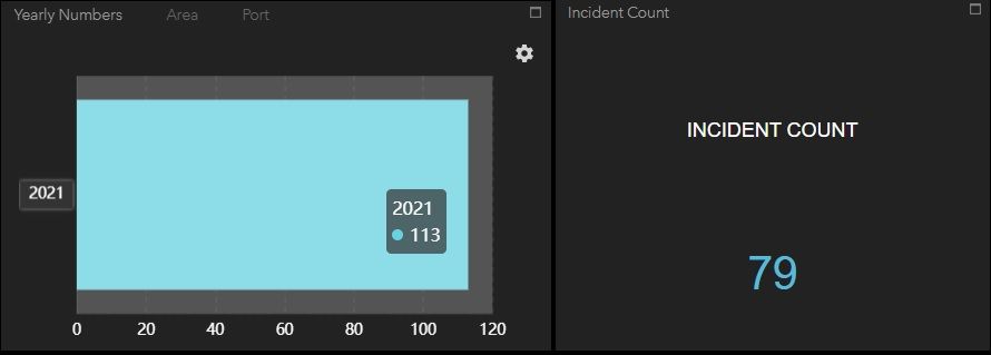

I have the same issue which I did to realize for a long time! Is there a solution to this problem?
I update my feature layer every month. My widgets with feature count are not being updated automatically. Web map has been set up for auto refresh too. When I recreated a widget it shows the correct count.
Below you can see the widget on the left shows correct number as I recreated it. The one on the right is stuck with the old count.
