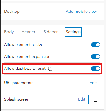

2. Allow dashboard reset so users can reset all the filters easily:
3.  Put really good info in a splash window to explain how to use the dashboard.
