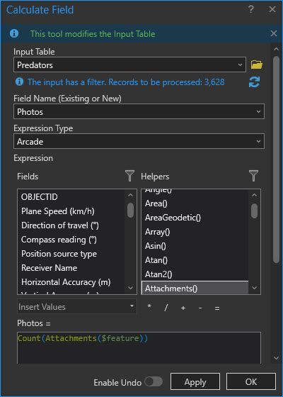

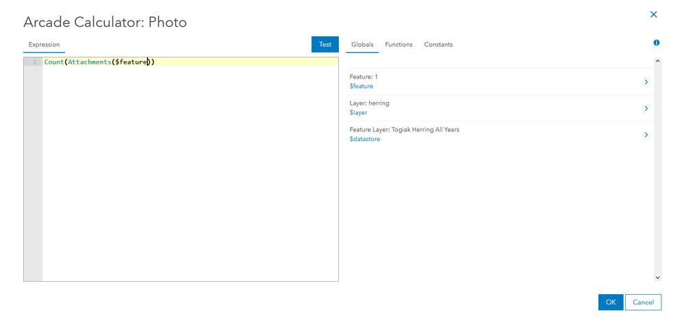

Sure for hosted feature layers you can calculate the photo field in AGOL or Portal by clicking on the field 'Calculate' and typing in the statement in the first screenshot. Alternatively in ArcGIS Pro you can calculate the Photo field by right-clicking on the field 'Calculate Field'  (2nd screenshot).

Hi  Stephen,
