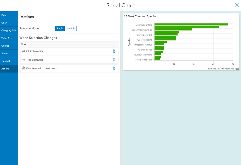

Looking at other related queries, it seems like the map layer should be showing up under Actions in the element's configuration, but it's not.

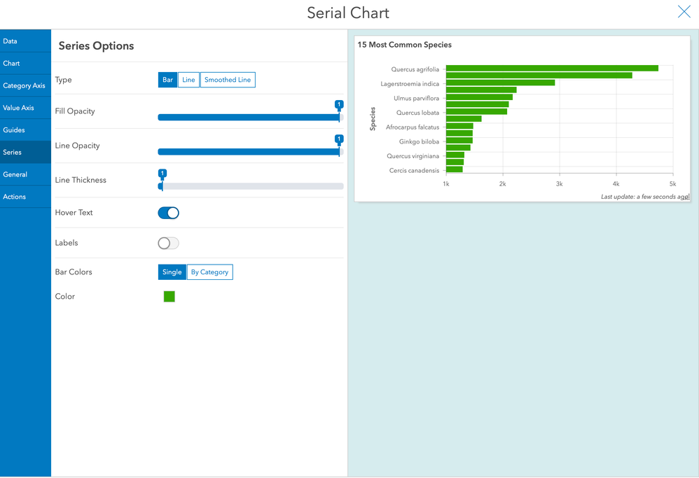

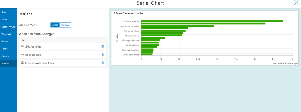

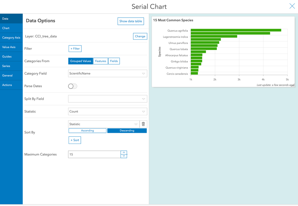

Are you able to share some screen captures of the serial chart settings? 'Data' and 'Series' would be useful.
I have seen this before though I can't quite remember the exact issue... I feel like it is something to do with the way the chart is created, though I may be wrong!
Jamie.
KelaineRavdin
Jamie,
Yes, thanks! Attached here.
Screen Shot 2021-04-12 at 13.32.35 .pngScreen Shot 2021-04-12 at 13.32.45 .pngScreen Shot 2021-04-12 at 13.32.57 .png

Try building your category selector from "Features" instead of "Grouped Values" as the map actions are different depending on the category selector type. "Features" allows Flash, Pan, and Zoom (in addition to filter). Hope that helps!
