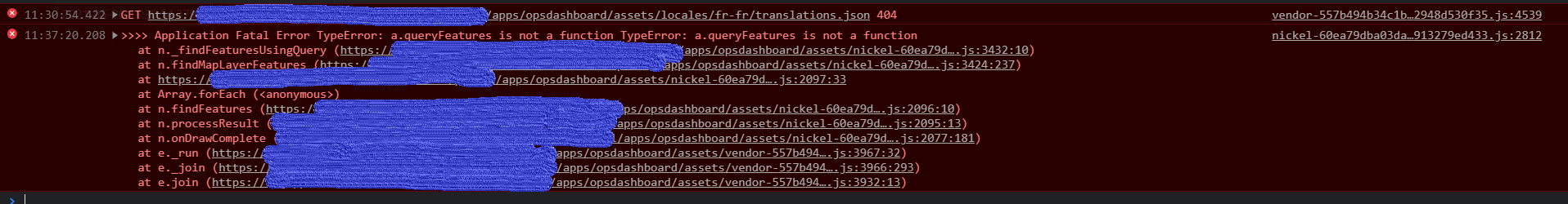

But when I want to select multiple elements :
Application Fatal Error TypeError: a.queryFeatures is not a function TypeError: a.queryFeatures is not a function
