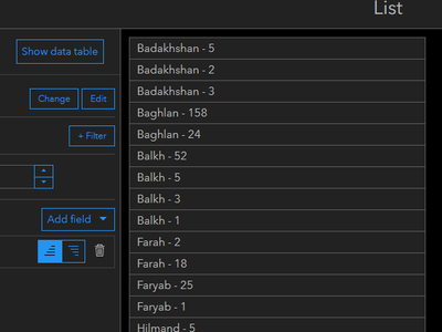

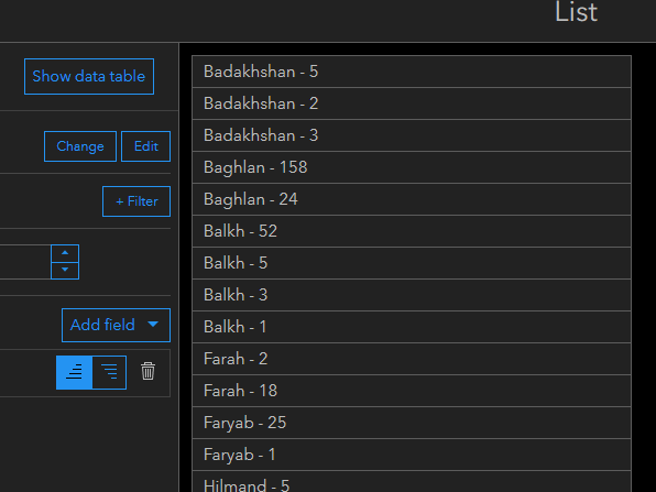

Using the List Element I am taking multiple layers and out of that, I am going to count the number of reportIDs per Province to know how many monitoring visits were carried out in each province. But looks like it doesn't count properly and the province is not listed uniquely. With my very light knowledge of Arcade I can't figure it out, any help will be appreciated:

You have to do a final GroupBy on layersDict to get the sum of all counts.
// do a final GroupBy to add all reports in each province
var layers_fs = FeatureSet(Text(layersDict))
return GroupBy(
    layers_fs,
    ['provinces'],
    {name: 'TotalReportCount', expression: 'count_of_ids', statistic: 'SUM'}
Have a great day!

SayedWali
Thank you! worked out
