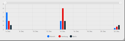

The graph looks like this
This is exactly the result I needed!
Thank you ao much,
