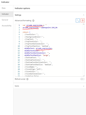

I don't think you won't be able to directly call the arcade from the pop-up, into the indicator,
Rather you will need to copy and paste the expression into the Indicators, advanced formatting section, and call this into the return statement:
An example of completing this is below:

Ok thanks, I think I can figure this part out now, thanks for the response
