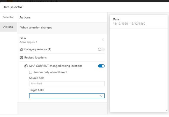

I have a dashboard map with just over 1000 locations across the UK. I have successfully created a number of selectors but what I really need is the ability to show locations based on the date assigned to them (specific dates and ranges covering a year, a month etc.). My chronological range is 1550-1560 and all dates are in the DD/MM/YYYY format. I have been experimenting with different date selector setting for many hours but no filtering ever happens. Please help!

So I think the possible cause of the problem is that Source Field and Target Field and not editable - 'no matching option'. Is there a relatively simple fix for this please? The ones I've seen on the forum are a bit overwhelming for a newbie like myself.

Many thanks for this. I may try this solution if I can't get my method to work. Having done more research I followed someone's advice to add a new Date field in the featured layer's data and copy the contents of the original Date column there. It went relatively smoothly and once the data is displayed in Dashboard the Target field in the date selector now shows my duplicate date column. I select it and lo and behold I can now do all the wondrous things with the 1000+ dates in my map that I have always dreamt of doing. There is a but though. For reasons which I struggle to comprehend the duplicate date field displays my original date of '1/13/1555' in this format '1/12/1555, 11:58 PM'. In other words all dates show the day before. I'm guessing this has something to do with time zones but how to fix this I don't know.
