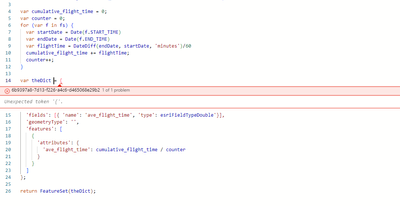

Awesome @KenBuja! I have added the script you supplied above, I am very grateful. I am getting an error in the second part that I cannot figure out.
I have added our portal and the Feature id, those are the only changes I have made.
Thanks for your help.
KenBuja
MVP Esteemed Contributor
Sorry...I left out a quotation mark on line 15
  'fields': [{ 'name': 'ave_flight_time', 'type': 'esriFieldTypeDouble'}],
JustinH
Thanks so much! It worked!
