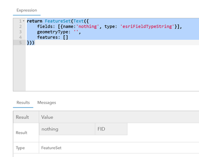

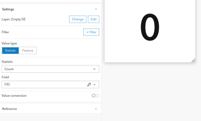

It returns an empty feature set. I created another script that returns an empty feature set and that one indeed works fine (thanks, @jcarlson!). It might be something in the script (or data, or most likely portal).  Here it is:
