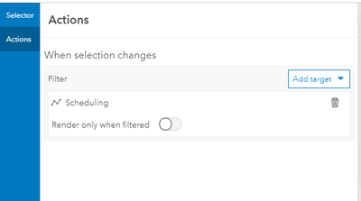

SNyquist
I noticed this issue with my version of Portal (10.8). The Filter Tool is missing. Is this tool in the latest release of portal?
