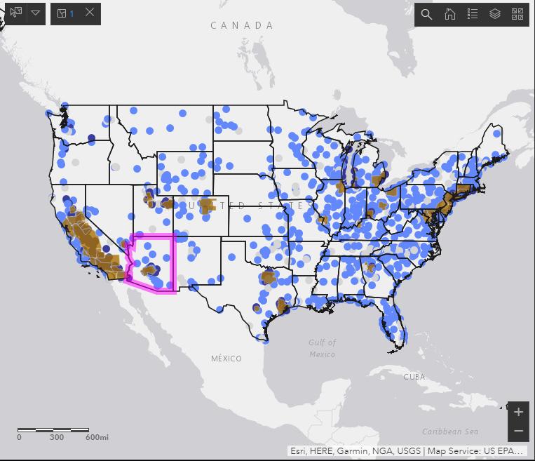

I've been having the same issue that is being reported here. For me it is related to the zoom. If I select a polygon when zoomed out, it appears to perform the filter based on the generalized polygon boundary of the feature in the zoomed-out map. Here's an example:

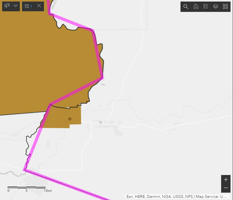

I selected the U.S. state of Arizona on the map. Here's what I see when I zoom in on the SW corner:
The black line is the "real" geometry of the state boundary and the magenta line is the geometry that persists from the selection of Arizona when I was zoomed out. So any kind of spatial filter on the brown polygons to determine which ones intersect Arizona will clearly pick up the brown polygon to the left of the black line (in California), even though it is not in Arizona. As a test, I zoomed in to make the selection and the magenta line followed the black lines with more fidelity.
I understand that the linework is generalized for display purposes when you zoom out, but it seems odd to me that the selection is based on that generalized linework rather than the true polygon boundaries. This seems like a bug?
StevenJett1
Images didn't seem to come through. Here is the first image:
Dashboard selection problem
And Here's what I see when I zoom in on the SW corner:
Zoomed showing polygon selection problem.
