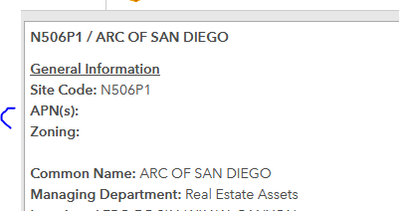

I noticed recently that the details element of operations dashboard doesnt show my arcade expression in the pop up menu. (see pictures below)
Pop-upDetail element:
Thank you,

Currently, arcade expressions are only supported in pop-ups in the web map within Operations Dashboard.

Thanks for the response Derek Law, but it use to work until a couple weeks ago.
I found an old screenshot from Apil 18th.

Currently, Operations Dashboard for ArcGIS supports arcade in web maps in the following ways: layer symbology, layer labels, and within a pop-up. It's interesting to see it work in the Details element (I was not aware of this) ... and I suppose it's very similar in nature to the behavior of pop-ups in web maps. It could be a bug.
Can you please open an incident with Esri Tech Support so they can investigate further?
