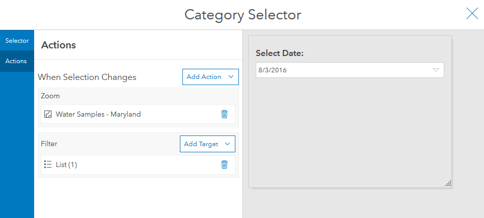

Yes, this should be possible. All you need to do is simply configure your date selector and add another Target for your filter action ... in this case, your List element. I've added an example screenshot below:
