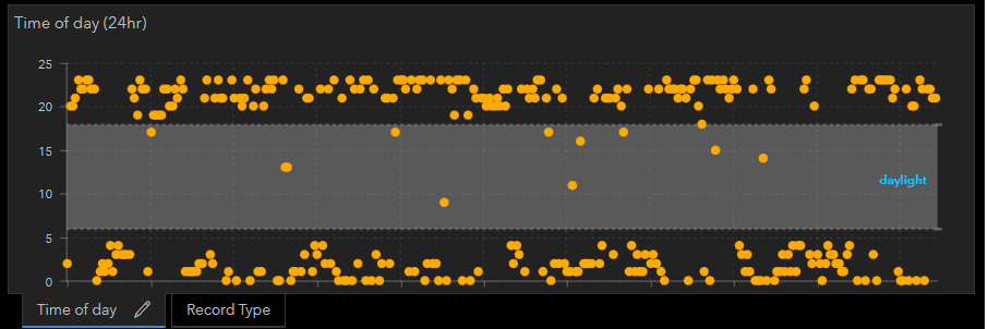

Seeking some assistance with what i think is just a formatting problem.
I've used this script in a data expression to power a serial chart showing the time of day in 24hr format for a dataset collected in ArcGIS Collector. The original reason for doing this as a data expression was to gain access to a field that just had the time of day (or rounded up to an hour value from 1 - 24)
Everything works well at this stage
What I'm trying to do now is include the original creation_date field in the featureset so that I can filter this field with a date category selector. As it is now, the creation date field is being treated as a string and when I attempt to apply a filter a this data expression via the date category selector, there are no valid fields to choose from.
If I change line 18 of the code from esriFieldTypeString to esriFieldTypeDate, the featureset doesn't return any records.
The creation_date field is actually of type esriFieldTypeDate, so the problem must be with my scripting. Any suggestions are most welcome

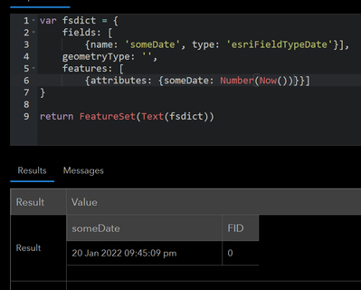

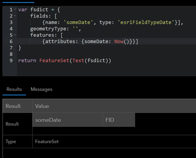

I've seen this sort of behavior in Data Expressions with date fields.
I don't understand why this works, but try casting it as a Number. In line 33, you'd put:
'creation_date': Number(feature['creation_date']),
Trying to use a date value directly.Trying to use a date value directly.
Cast as number.Cast as number.

I was stuck with the exact situation too.   Thank you, that worked perfectly for me also.  🙂
ChrisH2
Worked perfectly. Thankyou so much @jcarlson
