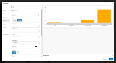

Thank you! How can I make the data label in the serial chart "suppressed" if the value is <= 5?
KenBuja
MVP Esteemed Contributor
I can't think of a way to include text with a numeric field to be used in a serial chart.
Could you use a Value Guide to hide those?

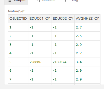

Another way you can do is to change all the values for the records you want suppressed to -1 (or another value) . You'd have to put a note in the chart saying what that value means. Here's an example, using a sample Esri dataset. This show the value that's being checked, but not the other values for each record. If you don't want to show that, remove lines 19-23 and uncomment line 24.
var fields = ["AVGHHSZ_CY", "EDUC01_CY", "EDUC02_CY"];
// Returns the first feature in the layer
var fs = Top(
  FeatureSetByPortalItem(
    Portal("https://www.arcgis.com"),
    "7b1fb95ab77f40bf8aa09c8b59045449",
    0,
    fields,
    false
  99
var features = [];
//return theDict
for (var f in fs) {
  var attDict = {};
  for (var a in fields) {
    if (fields[a] == "AVGHHSZ_CY") {
      attDict[fields[a]] = f[fields[a]];
    } else {
      attDict[fields[a]] = IIf(f["AVGHHSZ_CY"] > 3, f[fields[a]], -1);
    //attDict[fields[a]] = IIf(f["AVGHHSZ_CY"] > 3, f[fields[a]], -1);
  Push(features, { attributes: attDict });
return FeatureSet(
  { fields: Schema(fs).fields, geometryType: "", features: features }
