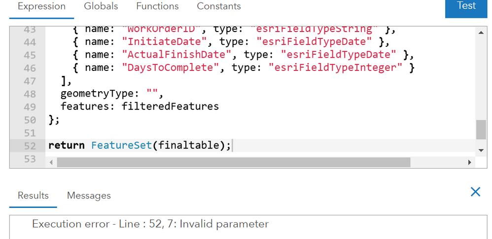

HaydenHarrison1
Hi Ken,
Thanks for responding. When I edited the code to your above suggestion, I got an invalid parameter error. ScreenshotParameterError.png
KenBuja
MVP Esteemed Contributor
I ran your code using my own data and discovered that you have to convert daysToComplete to an integer (line 34). Otherwise, it ran correctly (with some field name changes and a different minimum days)
