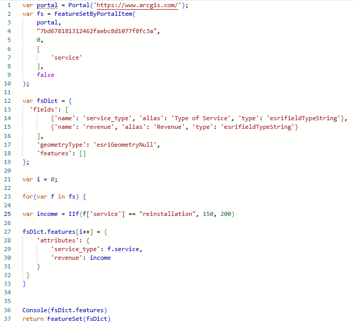

Hello,
I'm trying to create a feature set as the source for a table element, but my data expression gives the following error: 'Test execution error: Unknown Error. Verify test data.' I would greatly appreciate any help available. I'm very new to Arcade.
KenBuja
MVP Esteemed Contributor
Your error comes from lines 14 and 15, where you need "esriFieldTypeString" instead of "esrifieldTypeString". Case matters!

KenBuja

PlANNADMIN
Thank you so much! It works perfectly now. I really appreciate your help.
