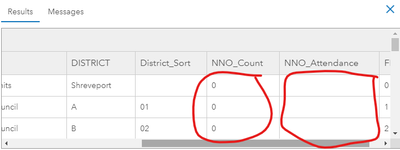

Edit: Well, I thought this fixed it. With the geometry turned off the intersect doesn't work. It returns 0 for the Count and nothing for the Sum. As soon as I change it from false to true both the Count and Sum work again, but the script is slow again.
Thank you so much for your help. This is exactly what I needed. I'm still trying to figure out all the ins and out of coding/Arcade. What's funny is when I first started trying to figure out how to write this data expression that is how I wrote my variables. Below was the first expression I wrote, but I found out that you can't write the expression as you do in pop-ups. I changed it when I found this Esri Webpage with an example I used.

Hi @JohannesLindner ,
I did mark it as a solution but then had to take it off as I noticed I wasn't getting any Count or Sum results. I added an edit to my response above, but I'll put it here too. Is the edit below happening to you too?
Edit: Well, I thought this fixed it. With the geometry turned off, the intersect doesn't work. It returns 0 for the Count and nothing for the Sum. As soon as I change it from false to true both the Count and Sum work again, but the script is slow again.
Kind regards,
Jerry
JohannesLindner
MVP Alum
My apologies, I really fudged that up...
I know that limiting what you load can speed scripts up, so that was the first thing I tried. I got a huge speed boost and left it at that without checking the result or diving deeper into your script. And I must have some confusion about loading geometries and Intersects(). Could have sworn you didn't need the geometries, but obviously that's wrong.
At least loading only the needed fields really gives a significant (although not 33 seconds...) speed boost:
