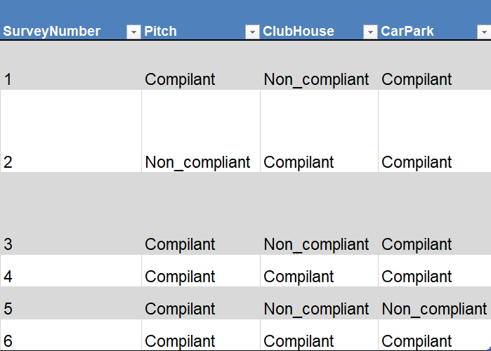

Hi everyone,
I'm new to data expressions and I'm having some trouble writing an expression to create a table in an AGOL dashboard. I need to write an expression that will count the occurrence of "Non_compliant" in a few fields of my  FeatureLayer. See screenshot of
I'm trying to produce a table like below in the dashboard:
Any help or advice would be greatly appreciated?

You can do this with GroupBy, which outputs a FeatureSet, so it's nice and easy.
var fs = FeatureSetByPortalItem(
  Portal('your portal url'),
  'itemid of layer',
  0,
  ['Pitch', 'ClubHouse', 'CarPark']
  false
return GroupBy(
  fs,
  {name: 'noncomp', expression: "'Non-Compliant'"},
    {name: 'Pitch', expression: "case when Pitch = 'Non_compliant' then 1 else 0", statistic: 'SUM'},
    {name: 'ClubHouse', expression: "case when ClubHouse = 'Non_compliant' then 1 else 0", statistic: 'SUM'},
    {name: 'CarPark', expression: "case when CarPark = 'Non_compliant' then 1 else 0", statistic: 'SUM'}
I'm not 100% sure the second parameter there will work, but if it does, this would be simplest. You could alternatively, build your FeatureSet from scratch, but you'd need to do three separate Sum functions for that.
- Josh Carlson
Kendall County GIS
Eimear
Thanks so much Josh! I really appreciate your help. I got it working, with an additional filter for a district field (see image below).
