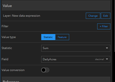

Use the Indicator's Built-In Aggregation
Using the same expression you've shared in your post, simply omit the Sum and instead return the distinctFeatures FeatureSet. Then on the indicator settings, set the Value Type to Statistic, set Statistic to Sum and select the field you want to sum.

AdrianPatrulescu
Hi Josh,
Thank you for your quick response
Using Indicator's Built-In Aggregation worked for me
var features = FeatureSetByPortalItem( Portal('https://www.arcgis.com'), '98cca0ba2d58470b96061faa24421e66', 0, ['ID_FCC', 'RestorationArea','RestorationType'], false );
var filterFeatures = Filter(features, "RestorationType <> 'Riparian'");
var distinctFeatures = Distinct(filterFeatures,['ID_FCC','RestorationArea']);
return distinctFeatures
And after I use sum statistic on the field 'RestorationArea'
