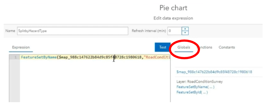

It looks like that inside the data expression editor of my sample ArcGIS Dashboard the "Globals" are missing
(as described in this video: https://www.youtube.com/watch?v=Dub1Ako2ljw&t=1008s😞Globals.png
Is there any setting or somethings else to get it?
Thanks and regards,
Daniel.

Globals are not available in Data Expression.  You have to use FeatureSetbyPortal.  I'm struggling with data expressions myself.
https://www.esri.com/arcgis-blog/products/ops-dashboard/announcements/introducing-data-expressions-i...

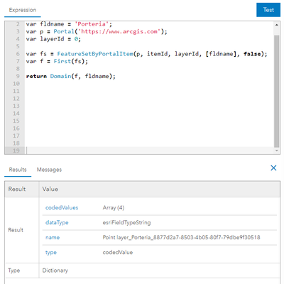

I think it is not the FeatureSetByPortalItem() function that is doing this. I just did a small test (in a pop-up, not in a data expression) with this function and I have access to the domain after reading the featureset with the FeatureSetByPortalItem() function.
So, could I wonder what is the data source of the data? Are you working with ArcGIS Online or with Enterprise (and if it is Enterprise, what version)?  When you include the expression in a pop-up do you have access to the domain? I will do a small check within a Dashboard because maybe it is something related to the way Arcade has been implemented in the Dashboards.
