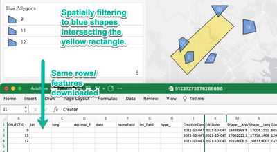

@NeilWebber Thank you for posting back to this with what you've been able to determine from Esri.  In the process of trying to figure out where the extra points were coming from in the exports I did some follow up tests with the exports.  Because the density of points was so high in some of the areas where we were using the spatial filter, it was sometimes resulting in several thousand extra results in the CSV output.  The data consistently lined up normally to the expected geometry in all of the widgets but the export appeared to be consistently applying some type of bounding box geometry to the output.  I re-created feature layers from the outputs with thousands of extra points and all of these points always lay outside of the circle but within a square geometry around the circle -- i.e. they existed in NE/SE/SW/NW areas around the circles.

We have updated the API to now take the actual geometry into account when doing the spatial filter on a CSV export. So, when you apply a spatial (polygon) filter action to a list of features, then export the source data, you will get the same number of rows in your CSV.
This update is planned to roll out with next week's ArcGIS Online release. Please let me know if you have any other questions or concerns with this implementation.
