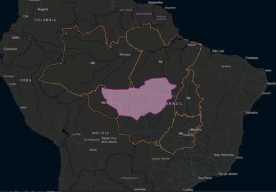

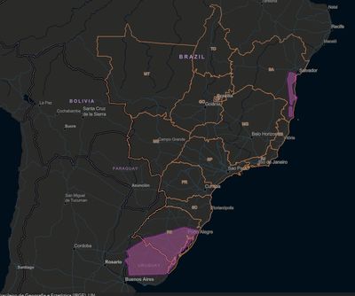

Sorry for reviving this post, and maybe this is not the most appropriate place for asking this, but it seems that i'm having a similar issue. I have several polygons result from a clusterization for most of South america. I'm trying to implement an spatial filter for Brazil's state borders, but it seems to keep using the polygons envelopes for filtering instead of the real area. Specially bizarre are the cases when the cluster consists of more than one polygon, in which case it will filter through the envelope of the whole group.
Any ideas? Is this a recurrent bug or i'm missing something?

I'm getting the same issue here, it uses the polygon envelopes, and not the actual geometry.

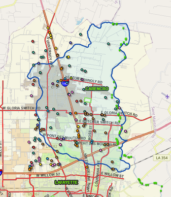

It appears the issue is still occurring.  Trying to filter point data within a polygon feature.  it is still selecting all points within the square extent, not the actual polygon.  the polygon layer came from an online source, not a csv.  I tested the layer's ability to filter in ArcPro and it filters properly, only points within.  has there been any updates to the issue?  is there a different workaround?
