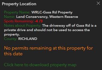

Is there a way for a dashboard to recognize how many survey123 surveys are currently opened? We have a reservation system built for Ohio hunters to use to check into certain properties. Each property has a limited number of spots. We currently have the dashboard set up so if the number of spots available gets to or is less than 0 the link for the survey will not work. However, we do not want the number to ever be less than 0 but we are getting numbers in the negatives. I believe this is because multiple people can have the survey open at the same time and submit it resulting in negative numbers. I am wondering if there is a way for the dashboard to count the number of surveys currently opened, or something that limits users to the spots available. I am also open to other ideas as to how we can solve this issue.
We have also implemented a timer so hunters cannot sit on spots, but still in under 3 minutes the spots are filling up more than they should. Additionally, survey123’s timer is editable in mobile surveys and sometimes defaults to --:-- -- making it so hunters cannot check in. I am not sure there is a fix to this as these are know issues with survey123 but if anyone has suggestions I would love to hear them.

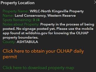

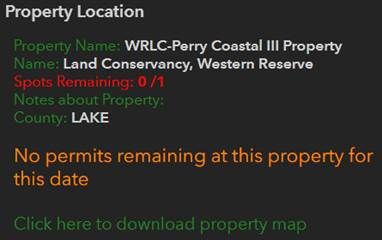

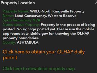

Below are a few screen shots showing the multiple scenarios, all are okay except for the negative example. This is saying the property has 7 hunters checked into a property that should only allow 3. Also, I pasted in the arcade scripts we are currently using to get the current number of submissions along with the link for submissions.
