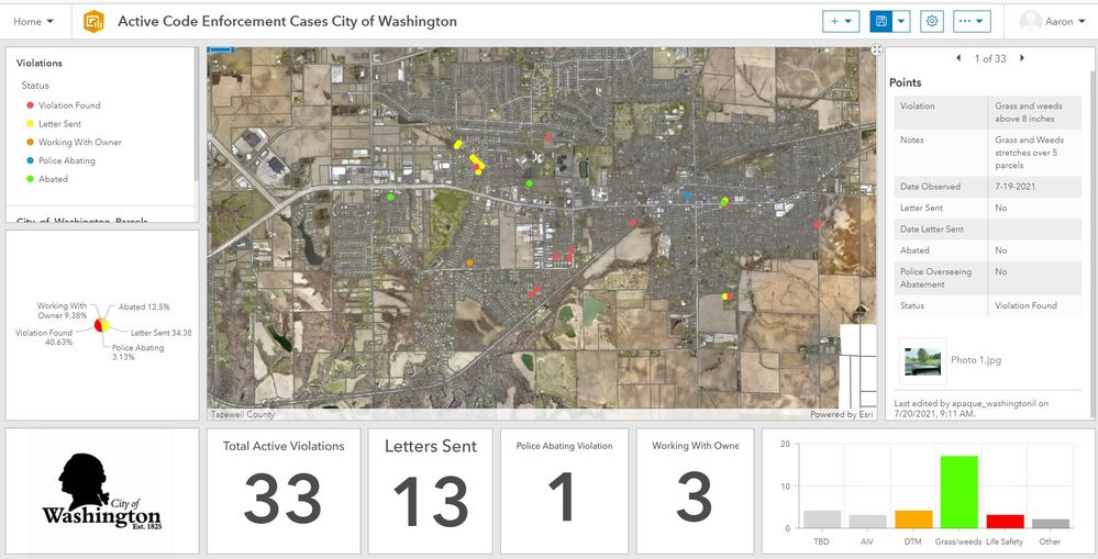

Here is the mostly final result of what I was attempting to accomplish. Using points instead of the polygon parcel layer made this a lot easier. The color of the points is based on its current status. The feature layer is easily editable in the field while conducting inspections, while at the same time having a consistently updated dashboard.  I'm pretty happy with the result.
One thing to note, the points are captured using field maps. Having points was a much better solution for tracking. I can put the point down of the exact location of the violation.
