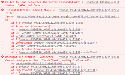

We published an ArcGIS Dashboard to the public about a month ago, and everything seemed to run fine.
However, randomly this week - opening any ArcGIS Dashboard content - whether published, or in edit mode it begins loading with the three blue blocks as normal, but then stops and leaves a blank white page.
Strangely, other ArcGIS Online content like Web Maps and Apps load fine - but just not any Dashboard content.

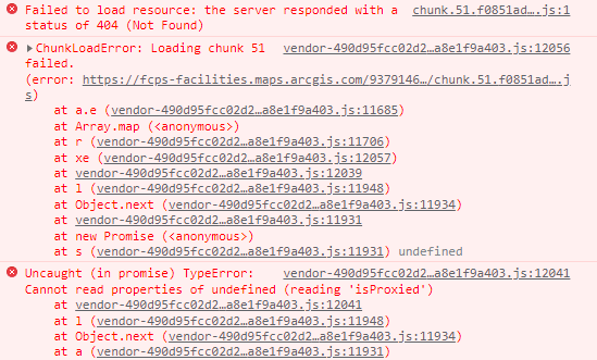

Four error messages display in the console, if this helps:
Any help, thoughts and advice would be helpful.
Thanks

Have you checked the data sources used in the dashboard?  Could they have been removed, renamed, or the permissions changed?  How about server property changes? or licensing?  There could be a variety of reason for the errors you are receiving.

Any difference with other browsers or private/incognito mode?
djager_fcps
Unfortunately, our IT doesn't allow us to use incognito mode. I suspect it could work though on this.

I am having the same issues for all dashboards I have created...dashboards shared both with my organization and publicly appear white when I try to open them in edit or view mode. However, I just opened an incognito browser and they opened without an issue.

Not yet, we have both Esri and our IT looking into this. Web traffic suggests it could be a Javascript chunk being blocked, but not confirmed.

@djager_fcps Can suggest reviewing the browser extensions that are enabled. May find by disabling certain ones will allow dashboards to be viewed without incognito mode.
djager_fcps
Thanks, this is another thing which has been suggested, but unfortunately we only have control over certain extensions in both Chrome and Edge from our IT. We tried turning off the ones we could, but no avail.

I was able to open my dashboards without incognito mode by disabling a Mendeley Web Importer extension.
