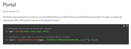

I suspect that you can't use the portal function to return a feature set from a REST endpoint like this - the Arcade documentation suggest that is used only for AGOL and Enterprise Portals. That could just be my limited knowledge of Arcade though.
Can you just add the layer into your map from its URL and work with it from there?
