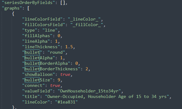

I would like to know if there is the ability to change the bullet to anything but a circle for the Serial Chart element (aka line graphs). I experimented with the .json export from ArcGIS Online Assistant, and noticed that the "bullet:" can be changed. I experimented with "square" and "diamond"; both of those work. However, I would like to know if there are any other shapes that I can use. For example, I tried "triangle" but that didn't work.
I was wondering if there is any documentation on the library or class that "bullet:" references. I couldn't find anything on ArcGIS Dashboards documentation published/available online.
