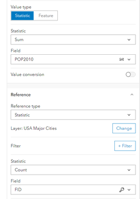

How is your indicator configured? It's showing a sum? If you're aggregating the data in your indicator, the count of the records won't be directly accessible in the $datapoint.
You may be able to do this with a reference value. Your reference value can be the count, the value can be the sum.
Then in your Arcade, you can reference the $reference value.
In regards to your Arcade itself, the Iif function is not followed by curly brackets. It follows the format Iif(condition, return_if_true, return_if_false).
Also, in your conditions, you are using the keyword return. When your expression encounters a return, it stops and returns whatever value follows that keyword, so only do that if you're at the "end" of your expression.
I'd love to give you a sample expression, but I'd need to know a bit more about how your indicator is configured, and possibly details about the data itself. Any chance the layer is public?
