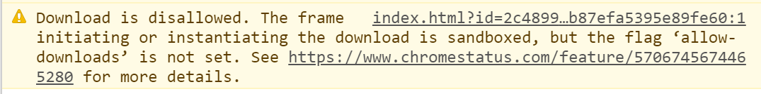

I configured a dashboard that has an embedded web app. The web app is built with Web AppBuilder and has the attribute table widget with the option to export to CSV.   I authored this last year and it has been working fine until recently.  It now fails with "download is disallowed" error message.   Does anyone know a solution to this?  Is this related to the recent AGO update?
I can still download the exported CSV from the web appbuilder app, but once it gets embedded to the dashboard, the error occurs.

That message looks like it's specific to Chrome's security settings.
If you follow the link the error message, you can see that downloads coming from an embedded frame is a Chrome no-no. Do you have access to the embed code of the widget to change the sandbox attribute to sandbox="allow-downloads"?

I've tested an embed with downloads, and I can confirm that this is a Chrome issue. Downloading from other browsers works fine.
There is a way to disable the sandbox settings in Chrome, according to this article. I don't use Chrome personally, so proceed with caution if you decide to go that route.

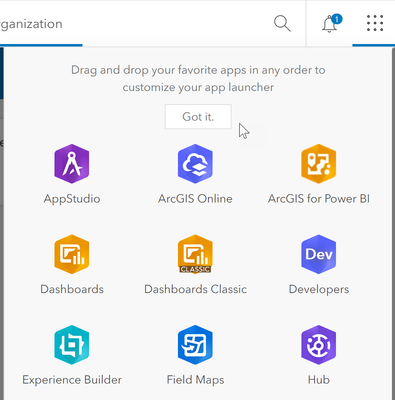

AhjungKim4
When you log on to AGO expand the menu on the upper right corner (just next to your profile icon).  You should see the Dashboards Classic app there.  The URL is   https://ORGNAME.maps.arcgis.com/apps/opsdashboard/index.html#/home
Author a new, classic dashboard and save.  If you need to revise this classic dashboard later, make sure you access it by going to the Classic Dashboards URL again.  If you open it from My Content, like you would normally open any AGO item, it will automatically open it as a new version dashboard.  If you revise and save, it will be saved as a new version dashboard.  I didn't know this and had to author the same classic dashboard twice. 😑
