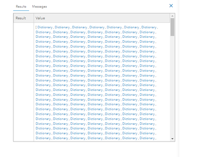

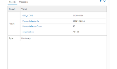

ALICEANSTEE
Update as of 05/07/2024. I've check the return of the features just before the creation of the var joinedDict and it returns the multiple dictionaries with a correct join (fab!). I've now been trying to merge the dictionaries together to create one.
This is one of the individual dictionaries:
any ideas on how best to do this? I assumed iterating through each would be best?
Thanks!
