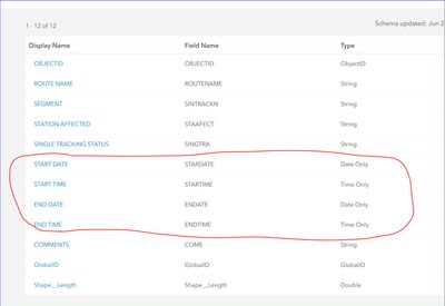

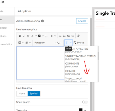

I added Date and Time fields to a layer, but these fields are not available for insertion in the line item template of the List Widget in the operations dashboard. Please note that these fields are of type 'Date Only' and 'Time Only'.

@Cepero_Eudel This is not a bug per se. Rather, Dashboards has not yet added support for the new date-only, time-only and timestamp offset field types. This is something on our radar, and on our TO DO list. As of right now, we do not have a target release for adding this support. Using field type 'date' (as you have discovered) works, and @jcarlson is on the right track using Arcade if the desire is to have the contents of the date field formatted to look like date-only or time-only.

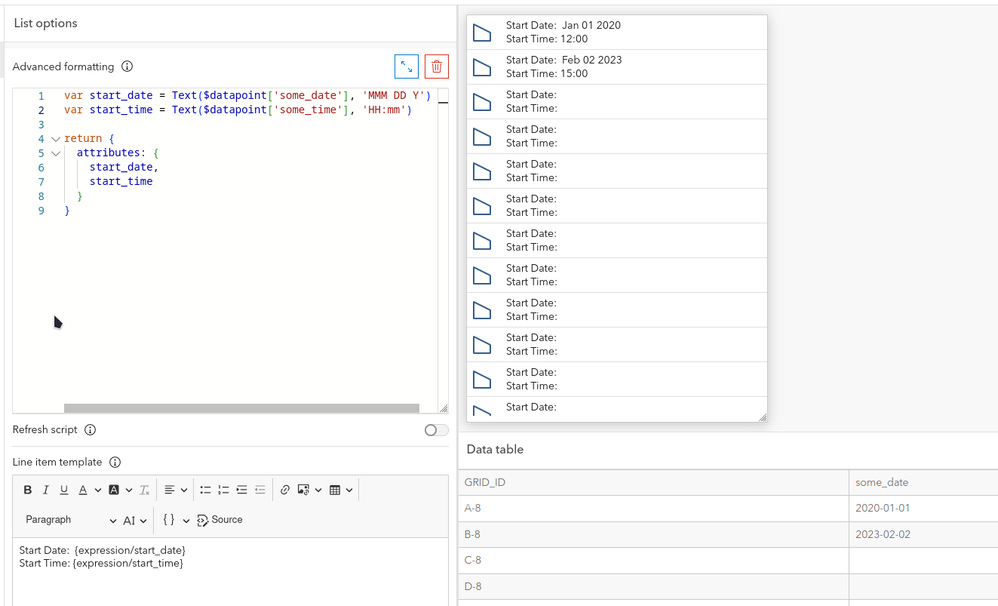

For now, it looks like you'll need to use Advanced Formatting to pull in those attributes.
