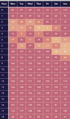

My end goal is to have a heat chart based on hour of day/day of week for calls for service. However, I have a filter on the date range so the color heat groups need to adjust as the data adjusts. I'm unable to figure out a way to gather all sum values and put in an array for me to get the max and min from the whole table. Below is where I'm at but I believe I need to somehow loop through the table using $rowindex?
Thank you in advance!

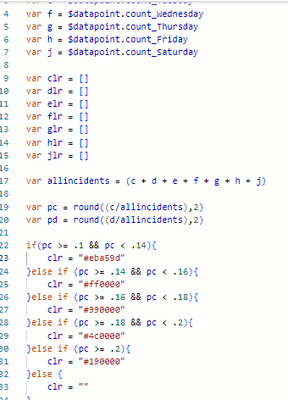

Lauren, did you ever figure this out?  I am trying something similar.  Works great with defined integers.  I also would like it to be dynamic and tried this.
It is a little off and I can't seem to dial it in.
