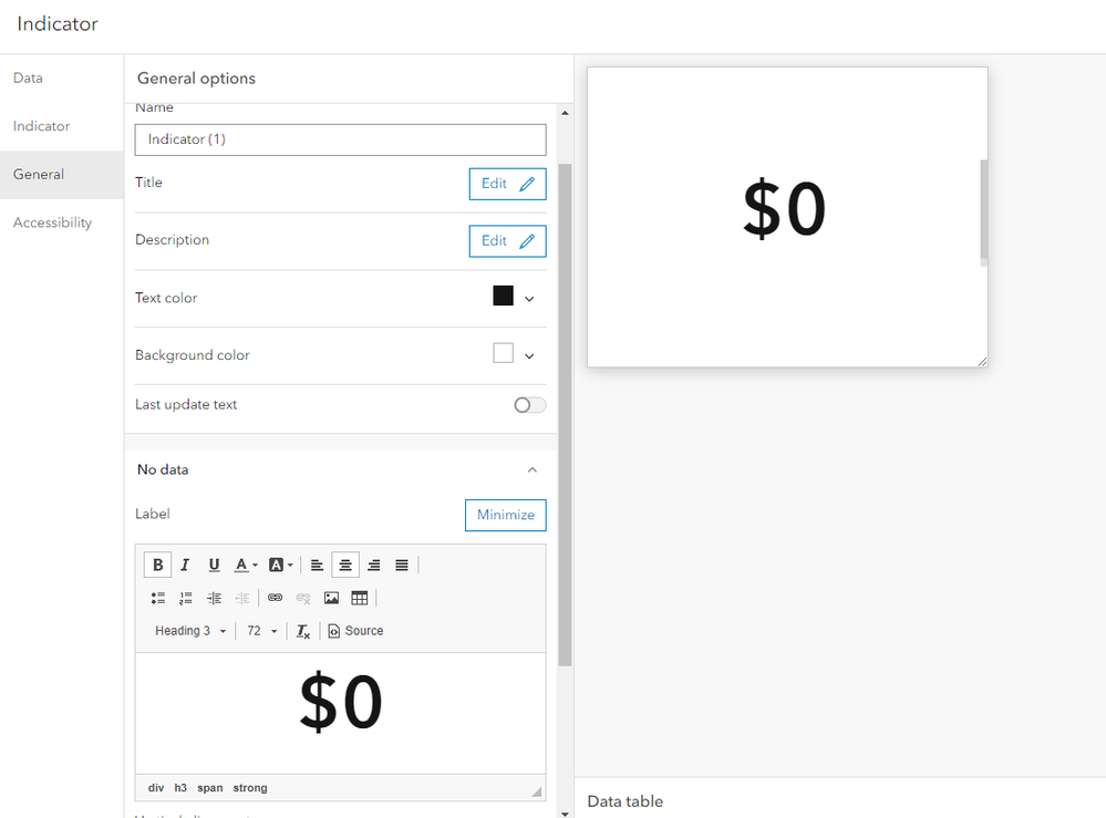

EllieHakariAK
Hi @DerekKonofalski! This isn't an Arcade solution, but still a possible solution to your problem. In your Indicator configuration settings, under General, there is a "No Data" section. You can add a label that will show in place of the "No Data" label that you're seeing. Here's how it looks when I try it:
