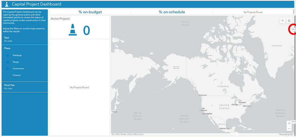

Let me preface this thread by saying I have never created a dashboard before.
In googling and browsing the ESRI forums and such, I came across the Capital Project Tracking solution dashboard that does basically what I am trying to accomplish. So, I started messing around with it and getting used to how it works. Now I have decided to use this as a template for the dashboard I want to do and have been configuring it with my information. But in configuring it, I have noticed that when I select a category from the Type section, the Active Project section quit updating based on the Type category I selected. This was updating when I first started configuring it.
So, my question is what configuration setting in the Type pane controls what Active Project shows up?
Ex. If I select Facilities, all the Project with a Project Type of Facilities should display.

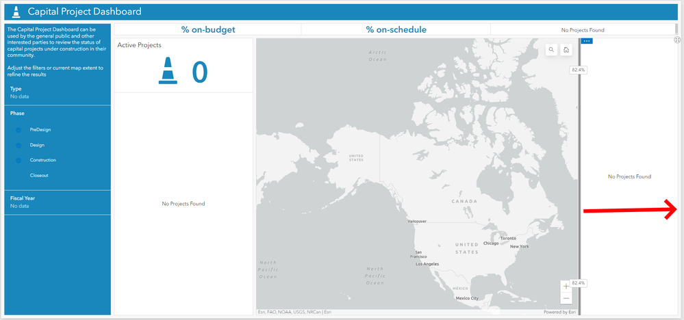

Is there a way to hide an element within a dashboard? For example, in the Capital Projects Tracking dashboard, the Projects Details element contains the same information shown in the popup. Therefore, the Project Details element is not needed in the dashboard. But if I delete it then the popup disappears so deleting this element is not what I want. So I am looking for a way to hide it.
Is this possible?
EllieHakariAK
It's puzzling that deleting the Project Details element is causing the pop-ups to stop showing up. Almost sounds like a glitch! If you're worried about repetitiveness, you could always go into the Capital Projects map and turn off pop-ups. That way the information will only appear in the Project Details element.
There isn't a way to hide elements, but you can just resize them until they're 99% invisible. I've seen people do this, although keep in mind that people who are GIS-aware may notice and be able to make it visible again. But that would only be on their end.
