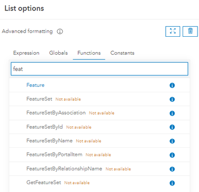

dcross
Thanks for the update here. This approach looks very promising but in the latest version of the Dashboard I do not seem to be able to use the function as suggested in the ESRI example.
FeatureSetByPortalItem
 I'm looking in the List widget configuration. I can enable advanced formatting, and that provides access to arcade expressions. Unfortunately it does not support many functions, including FeatureSetByPortalItem (indicated in the screenshot below as "Not available"). Am I missing something or has the dashboard changed such that this no longer works?
TijsLips
Hi,
You shouldn't be trying this in the Advanced Formatting section. Immediately after selecting the 'List' widget in your dashboard you'll get an overview of the available layers for the list. In that window there is a section that says 'Data Expression'. There is where you should be.
Hope this helps.
OliverIshmael
I believe the code example that TijsLips provided came from this article, which describes the process in more detail. Hopefully it helps someone: Introducing Data Expressions in ArcGIS Dashboards (esri.com)
