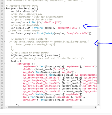

HashemAbdo
Hello  @JohannesLindner ,
I have one more question,
In some cases some SiteIDs will have two samples for the same Date and I would like both samples to be shown in the final product output. I was trying to see if another If statement that would see if the date in the latest sample date but it seems like Arcade doesn't let me do that. Is there another way of doing it ?
Something like that:
// samples
var sample_list = OrderBy(samples, 'sampleDate DESC')
if(latest_sample.sampleDate == sample_list[1].sampleDate )
latest_sample = sample_list[1]
Updated code:
var portal = Portal('https://arcgis.com');
var fs = FeatureSetByPortalItem(
portal,
'XXXX',
0,
'sys_estFreqReads_DeltaB16172',
'sys_estFreqReads_OmicronBA1',
'sys_estFreqReads_OmicronBA2',
'sys_estFreqReads_OmicronBA4',
'sys_estFreqReads_OmicronBA5',
'sys_estFreqReads_OmicronBA275',
'sys_sewershedName',
'sys_phu',
'sampleDate',
'siteID',
'lowQuality'
false
var dowDict = {
'fields': [
{ 'name': 'sampleDate', 'type': 'esriFieldTypeString'},
{ 'name': 'siteID', 'type': 'esriFieldTypeString'},
{'name': 'sys_phu', 'type': 'esriFieldTypeString'},
{'name': 'sys_sewershedName', 'type': 'esriFieldTypeString'},
{ 'name': 'sys_estFreqReads_DeltaB16172', 'type': 'esriFieldTypeDouble'},
{ 'name': 'sys_estFreqReads_OmicronBA1', 'type': 'esriFieldTypeDouble'},
{ 'name': 'sys_estFreqReads_OmicronBA2', 'type': 'esriFieldTypeDouble'},
{ 'name': 'sys_estFreqReads_OmicronBA4', 'type': 'esriFieldTypeDouble'},
{ 'name': 'sys_estFreqReads_OmicronBA5', 'type': 'esriFieldTypeDouble'},
{ 'name': 'sys_estFreqReads_OmicronBA275', 'type': 'esriFieldTypeDouble'},
{ 'name': 'dow_num', 'type': 'esriFieldTypeInteger'},
{'name': 'dow', 'type': 'esriFieldTypeString'},
{'name': 'lowQuality', 'type': 'esriFieldTypeString'}
'geometryType': '',
'features': []
// get all distinct combinations of ['siteID','sys_phu', 'sys_sewershedName']
//var sites = Distinct(fs, ['siteID','sys_phu', 'sys_sewershedName'])
var sites = Distinct(fs, ['siteID'])
// Create array for holding features, feat object for populating array
var features = [];
var feat;
//var newdate2 = Text($datapoint["sampleDate"],'DD-MMM-YY');
// Populate feature array
for (var site in sites) {
var id = site.siteID
//var phu = site.sys_phu
//var sewershed = site.sys_sewershedName
// get all samples for this site
var samples = Filter(fs,'siteID = @ID')
// get the latest sample
var latest_sample = First(OrderBy(samples, 'sampleDate DESC'))
// samples
// null check to avoid errors
if(latest_sample == null) { continue }
// create the new feature and push it into the output fs
feat = {
'attributes': {
'sampleDate': Text(latest_sample['sampleDate'],'D-MMM-YY'),
'siteID': (latest_sample['siteID']),
'sys_phu': Text(latest_sample['sys_phu']),
'sys_sewershedName': Text(latest_sample['sys_sewershedName']),
'sys_estFreqReads_DeltaB16172': (latest_sample['sys_estFreqReads_DeltaB16172']),
'sys_estFreqReads_OmicronBA1': (latest_sample['sys_estFreqReads_OmicronBA1']),
'sys_estFreqReads_OmicronBA2': (latest_sample['sys_estFreqReads_OmicronBA2']),
'sys_estFreqReads_OmicronBA4': (latest_sample['sys_estFreqReads_OmicronBA4']),
'sys_estFreqReads_OmicronBA5': (latest_sample['sys_estFreqReads_OmicronBA5']),
'sys_estFreqReads_OmicronBA275': (latest_sample['sys_estFreqReads_OmicronBA275']),
'dow_num': Weekday(latest_sample['sampleDate']),
'dow': Text(latest_sample['sampleDate'], 'dddd'),
'lowQuality': Text(latest_sample['lowQuality']),
Push(dowDict.features, feat);
// Convert dictionary to feature set.
//var fs_dict = FeatureSet(Text(dowDict));
return FeatureSet(Text(dowDict));
